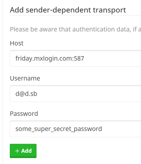

In Mailcow, go to Configuration (in the top menu) → Configuration & Details → Routing tab.
Under “Add sender-dependent transport”, add the login details for your account:
Once it’s added, click the “test” button next to it
Enter a from address at your domain, leave the to address as
[email protected]
, and ensure it works (you get a 250 OK at the end):Go to Configuration → Mail Setup → Domains, and click “Edit” next to the domain
